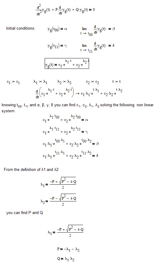

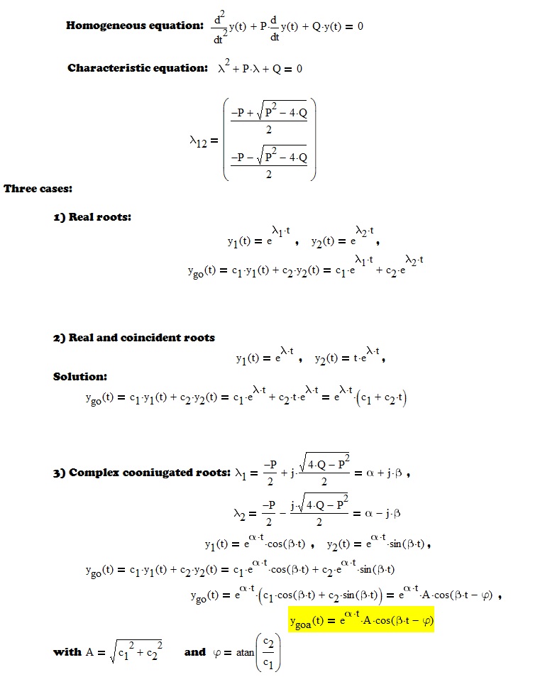

Knowing the general integral of the differential equation and some initial conditions, it is possible to determine the coefficients P and Q , in your case, C and k.
isavu1-VisitorAuthor
August 24, 2016
So i need to use the case of real roots, because i need real values that are going to be used later as parameters, and i don't understand how am i going to extract the values of c1 and c2 . Do i use the initial conditions? Because i don't think that's going to work...
August 24, 2016

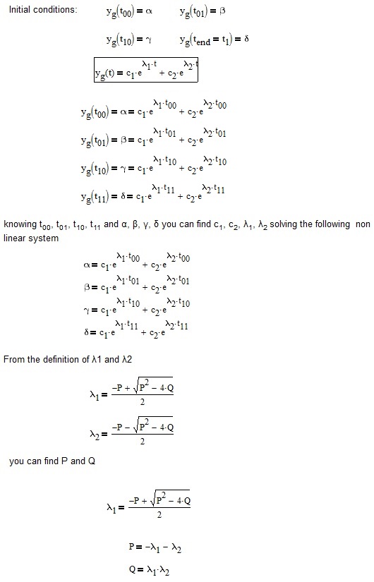

Hi Iulia,
you need four initial conditions:
If you know as initial conditions even the first derivatives, then the road to the solution is a bit different.

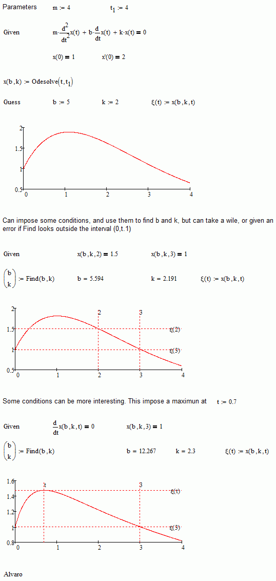

August 25, 2016
Hi Lulia.
You can combine an Odesolve block with a Find one.
Best regards.
Alvaro.
August 25, 2016
Thanks, Alvaro!
Yes - "Two equs with two unknowns" - see above.
But better in Prime with units: m:=4 kg etc
