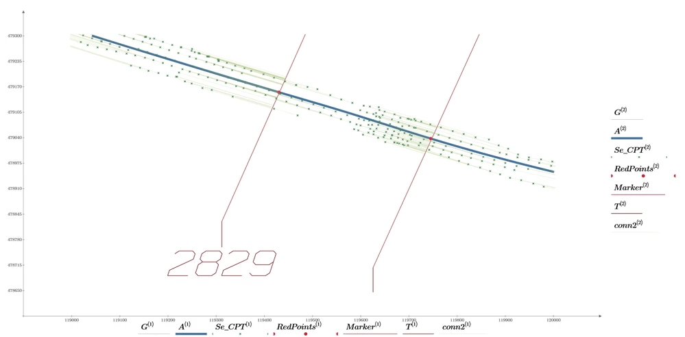

How can I draw the lines with specific points... in pervious thread we draw them each 200 m >>> Can it be drawn in specific distance using these values ( using the metreage values)
I tried to change the markers
and then I need to find the distance between these new lines and all the (Se-CPTs) points .  the distance between  the green point and the nearest metreage line
And then showing them in a plot .

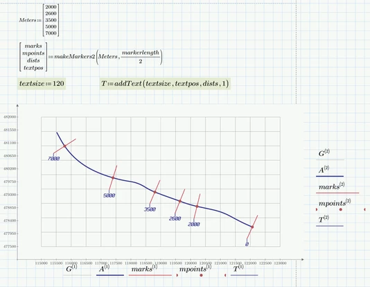

My new approach which is attached here uses interpolation to determine more precise the point with the given meterage. So most of the times none of these "red" points will be exactly one of the given "blue" A-points but rather would the red point lie in between two blue points. And so i define the normal to be normal to the line segment the point lies on.
The attached file contains both ways to define the distance and also provides means to plot the difference line segment. But even if you zoom in it looks confusing because there are way too much "green" CPT points too close together:

Its never a good idea to change the rule in midst of a game!
That said, the attached is just a quick hack to modify the already existing function makeMarkers to plot markers a positions provided by a vector.
Maybe you can use and modify it to your needs.
But your vector Meterage contains values which are far too large!! The whole length of the object is just 7500. So values like 22000 would have which meaning??

For the meterage it is too easy to implement it in AutoCAd  ... I think depending on your last file I can manage to add them. Sorry I provided the points of meterage not the distances I changed them as below
What I meant by  the distance between the line and The selected CPTs ... Can you see these green points ...I want to find the distance between them and the nearst red line you draw

Are you really talking about the distance from a point to the (theoretically) infinite line! Not to point on the blue street/river/orwhatever for which the the line is just a marker?
After all m red lines may look like the are perpendicular to the blue line, but actually thats just a crude approximation as a right angle never was demanded (you were initially talking just about 'vertical' lines).
Actually my red lines are perpendicular to the previous line segment.
Look at the sketch below.
The point P has the shortest distance to the red marker line associated to point #2, the point of the blue line closest to it it point #4.
So what kind of distance is the one you are talking about?
