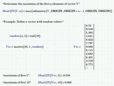

January 28, 2022
Here are some variants on the answers already given plus an additional one that allows you to choose whichever elements you want from A.
Note that the functions were written in Mathcad Prime Express 7.  Express does not have programming and so breaks a function down into a sequence of successive (functional) steps.
Mathcad Prime Express 7 worksheet attached.
Stuart

Or, in one go, and irrespective of the value of ORIGIN:
Prime4 file attached.

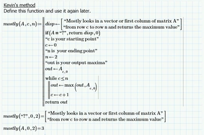

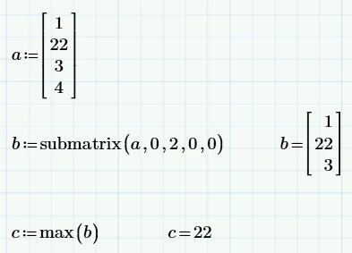

February 8, 2022
Hello, I can confirm that submatrix() and programs are applicable and are the intended approach.
However, getting back to initial request to "simple and elegant solution": Utilizing simple Mathcad definition capabilities, please compare this:
23-Emerald V
February 8, 2022
See the second line in my response - the shuffle was just there to randomize the data for test purposes (and provide a function that is potentially useful in other circumstances).
https://community.ptc.com/t5/PTC-Mathcad/Finding-the-Max-Value-from-Part-of-a-Matrix/m-p/775291/highlight/true#M199539
(the image is just a continuation of the OP's original)
Stuart
