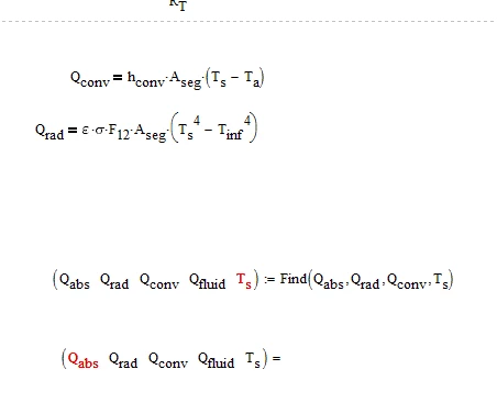

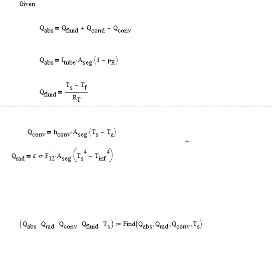

HI,
I am trying to find the T.s value in this file. Please  help me out. Thanks1.PNGEnergy balance equation on surface of tube (Taking solar energy as source)Energy balance equation on surface of tube (Taking solar energy as source)3.PNG

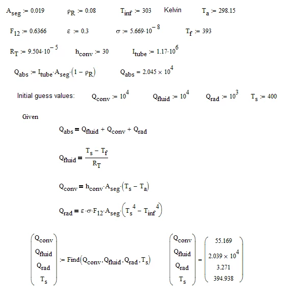

You shouldn't be solving for Qabs as it's independent of any of the other Qs and Ts.  It can be fixed above the solve block.  Either (i) you should include an expression for Qcond, including values for conductivity, thickness etc., or (ii) replace Qcond in the first equality within the solve block by Qrad (I suspect Qrad should be included in this first expression anyway, as Luc noted).  See below for my suggested solution for (ii):

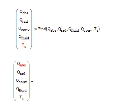

You have unmatched terms in the Find statement, add Qfluid to right hand side of the equation for consistency.
The left hand side should be a column vector rather than row vector.

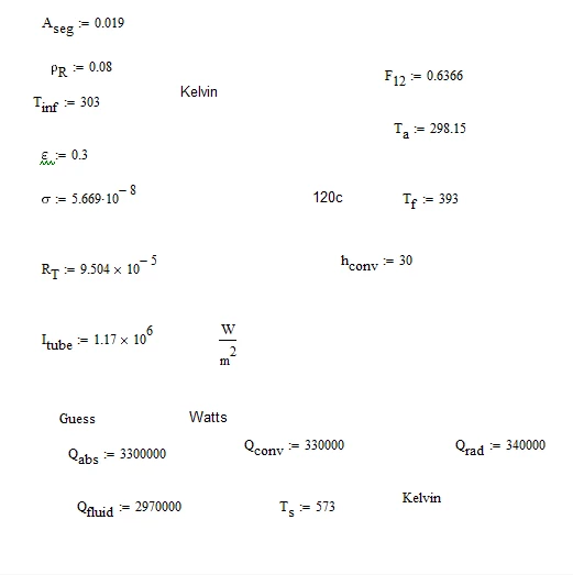

farhan071-VisitorAuthor
Thanks Terry for your help.
But i have tried it before as you said.Anyhow, i am uploading this file here. Please have a look and point out the error.
Thanks.

I should expect Qrad to be (also) part of the top equation in the solve block (the one with Qabs=Qfluid+...).
And what about Qcond?
