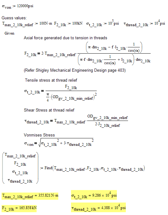

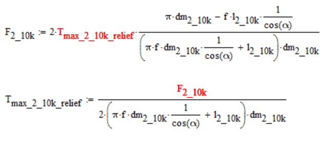

can any one help me in finding T.max_2_10k_relief in the attached file i would be happy if the solution is obtained by not using symbolic solver
here vonmises stress (sigmavon) is 120000psi

I know that....i'm looking for a numerical value for Tmax_2_10k_relief....
Use a numeric solve block
Replace the assigment := by boolean =
Provide guess values for the four unknowns
Assign sigma.von the value you named
Hope the attached helps

Thanks but i would prefer any other method without guess values or symbolic solver....
