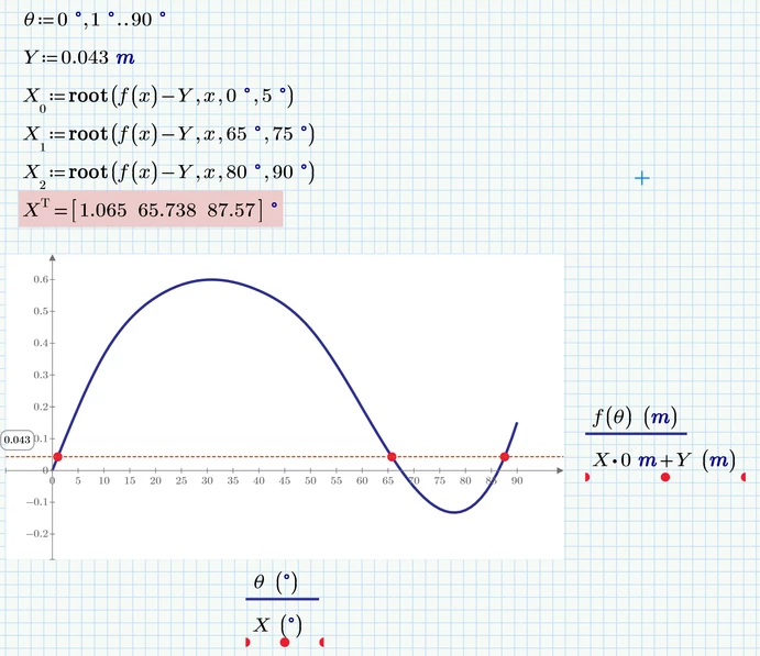

There are two more solutions larger than 60° in case you are interested
Remark: The extra solutions (especially the third one) are "created" by the usage of the spline interpolation (better: extrapolation in this case).

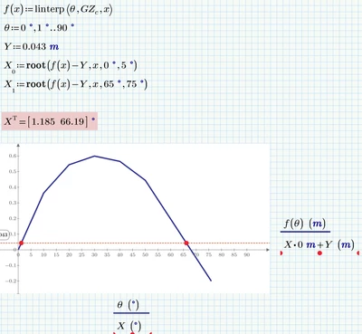

Here the result using simple linear interpolation (extrapolation for angles above 60°)
