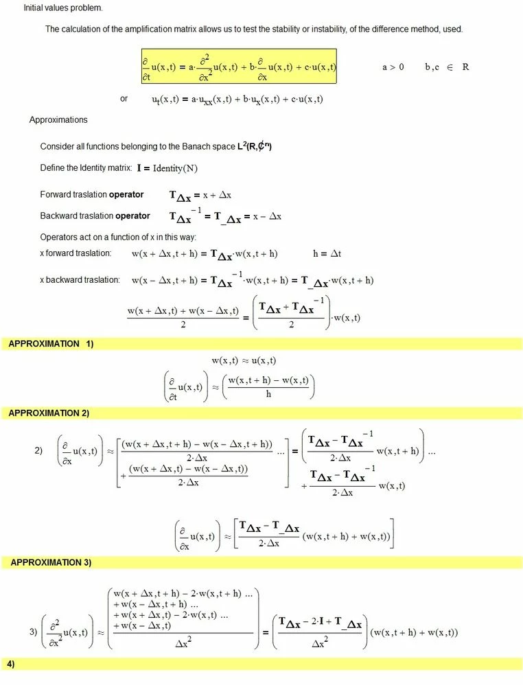

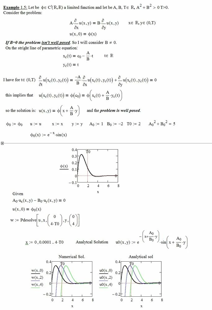

I Iramoslima,

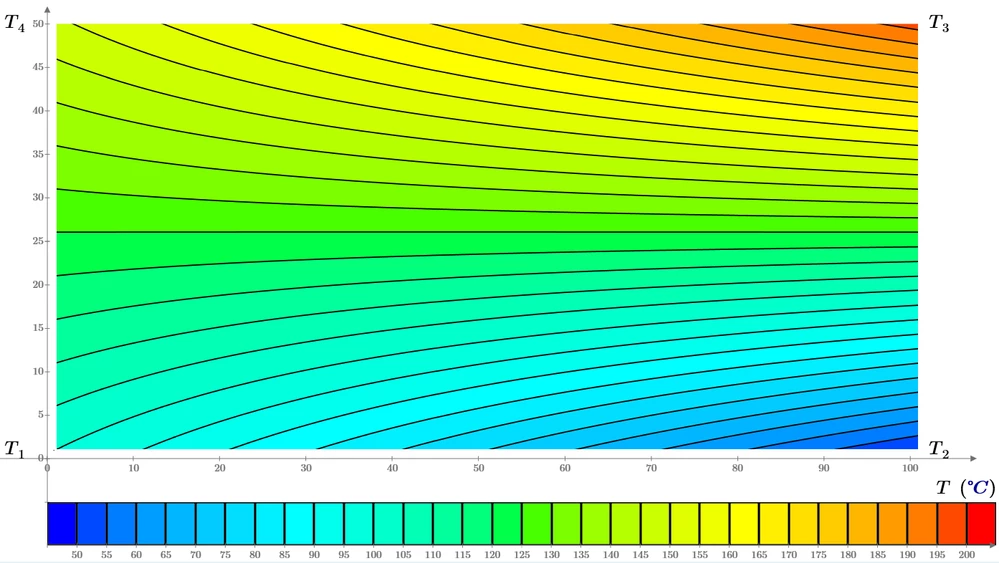

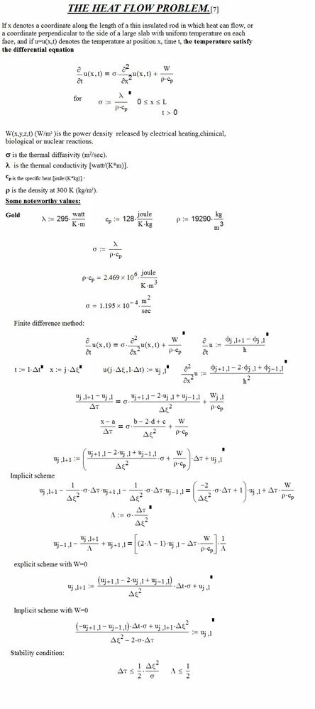

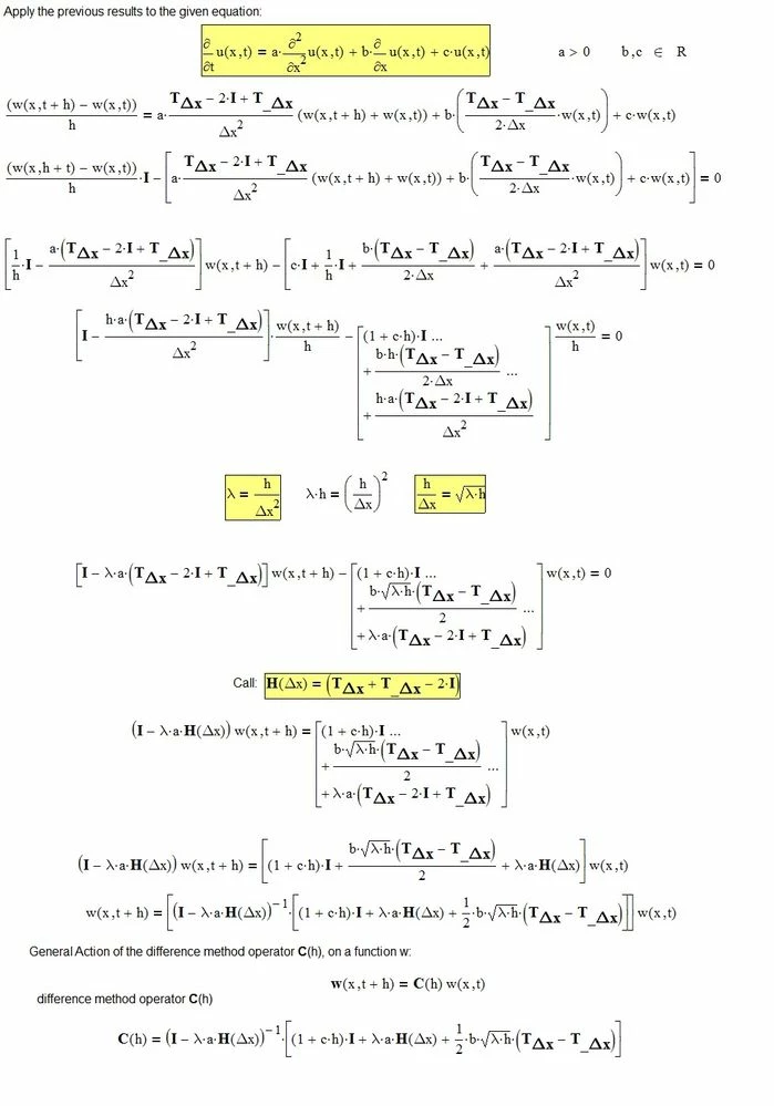

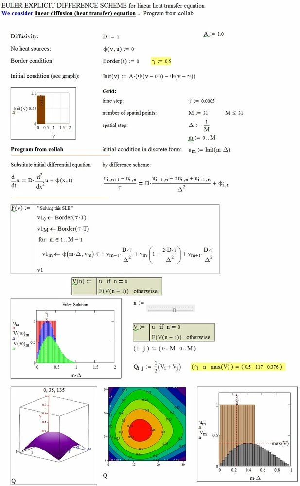

the argument, as you know, is vast and complicated. I give you an outline about the difference method theory which is almost similar to the one on finite elemets method, to get an idea of what it is. I add some examples, of which some are downloaded from the community. I forgot to tell you that some results must be verified since they are not copied by some text.
Greetings
FM
