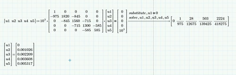

I don't use Prime but here is one way.
Picture.jpgI hope this is what you're looking for.
D.Shabani

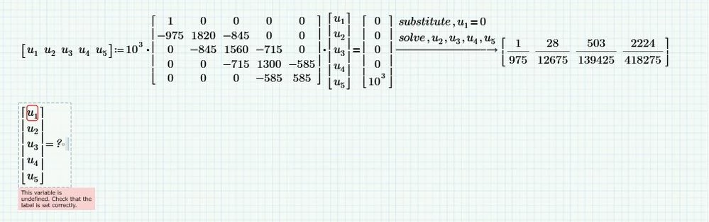

I wrote the formula but presented this error.
Exemplo02.jpgThanks !
