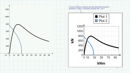

I have plotted the results from two vectors. The graph resembles the shape of a half circle and I would like to find a function that fits the data so intersection points can be determined for other functions.
I have tried many different curve-fitting tools but can't find a proper one that works.
I'm  thankful for any help!

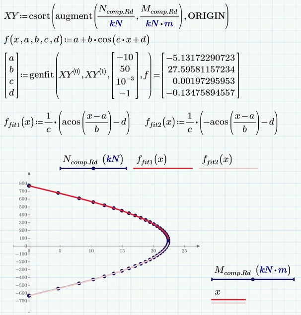

I get slightly different values using CurveExpert Pro
And I get similar values in Prime using genfit() (though genfit is VERY sensible wrt the guess values).
BTW, as we can see far to the right of the Prime sheet how the data is actually calculated it should not surprise that a sinusoidal fit is suggested by CurveExpert 😉

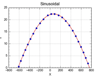

If I digitize the data, then rotate it so X is a function of Y, and send it to CurveExpert,, I get
Which has the form

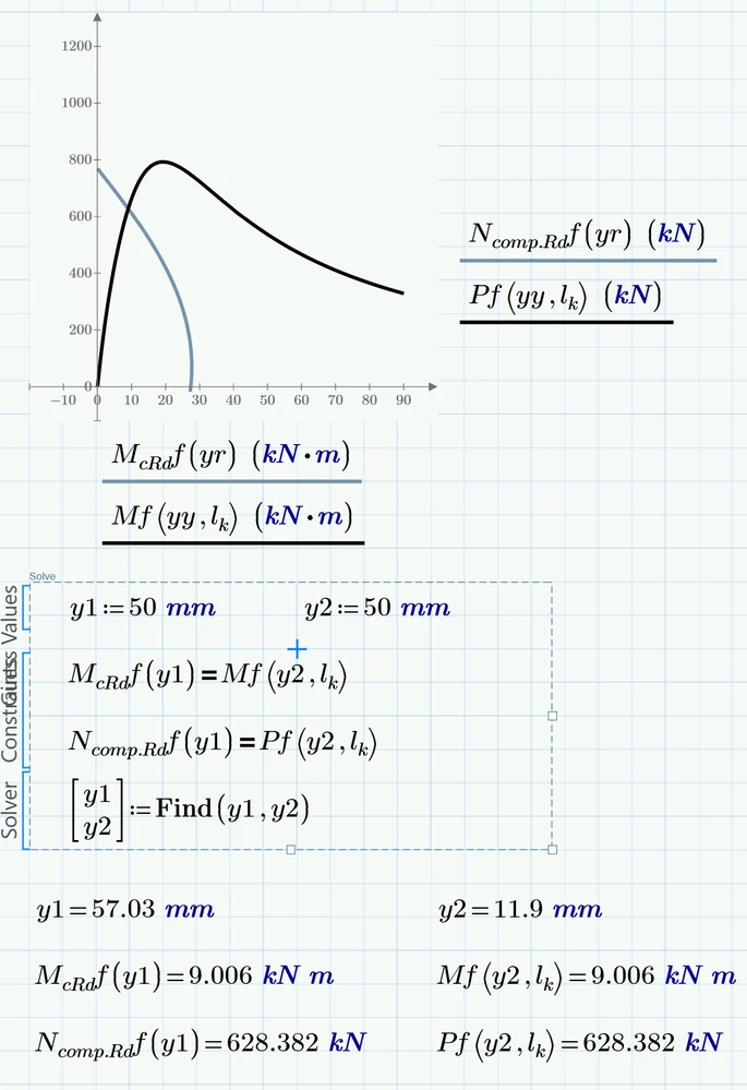

It is possible to define functions rather than vectors for your plots:
I've done it in the attached Prime 8 Express sheet.
Attempts to solve for the intersection (in Express) have failed; maybe someone with a solve block capability?
Note that it's possible to create functions only using the parameter "y", which would result in a single intersection point.  I introduced a second variable (l_k) hoping to be able to trace the intersection point as a function of that variable.
If only one point is required . . .
Good Luck!
Feb 24, 2023 8:33 PM UTC
Here you are ...
As solve block does the job pretty well but is a bit  sensitive wrt the guess values
