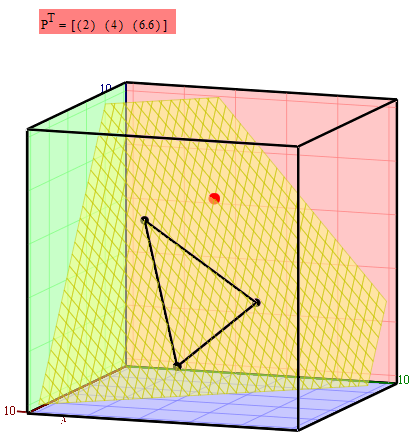

Try the attached.
Alan
13 replies
May by so:
Jbryant611-VisitorAuthor
Hi,, thanks. What happened to "d". And how would I then plot this plane as well as the 3 points on it?
Jason
Two of the points are identical (nbrs 2 and 3) so there are an infinite number of planes that could go through them!
You get rid of d by dividing through by your original coefficient of z.
Alan
I guess the attached file should help.
Thankyou. I love your graphic!
