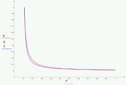

  • Uses PTC Mathcad solvers to fit a hyperbolic function to collected data
  • Applicable for fitting hyperbolic functions and can be applied to any sort of function
  • Uses the "minimize" solver function, hyperbolic function, plots, fitted curve, residual error, hyperbola, "miner" solver function
This worksheet using PTC Mathcad helps you to fit a hyperbolic function to collected data. This worksheet shows you how you can use the "minimize" solver function to fit a simple hyperbolic function to some data. You can plot the fitted curve with the data and calculate the residual error. You can also apply a more general form for a hyperbola. You can use the "Minerr" solver function to solve for the coefficients in the function.
