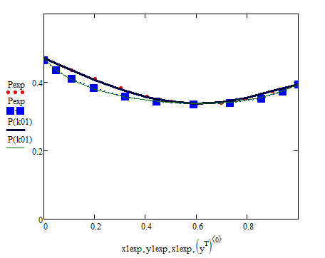

Hi Valery,
About the introduction of units in the worksheet, the function Z, that calculates the equation of state roots by the polyroot function, gives as output a vector whose components have different units ( dimensionless ( compressibilities factor) and pressure unit ( fugacities )).  I think a direct conversion to MathCAD prime should not be possible. correct?

Sorry, not correct!
We can try!

Data fitted with PR and SRK respectively:
