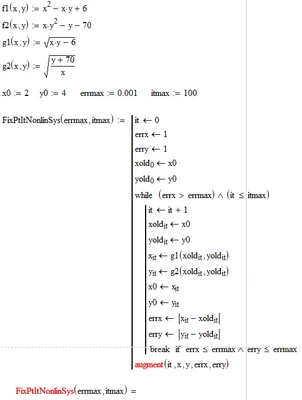

I try to make my Mathcad alghoritm to work for a nonlinear system by using Fixed-Point Iteration .  Unfortunately still I cannot get the results. Something is missing in my script. I attached my Mathcad file.
The results whould look finally like this  (I obtained it in Excel in order to compare the results if possible):

So your iteration attempts to solve:
That's a set of equations with the following (approximate) solutions:
The problems with your program are due to the fact that the augment() function (of the last statement) needs all its parameters to be vectors.
You have in there x and y, which are vectors (indexed using it), but it, errx and erry are simple scalar variables.
Apparently you want the iteration number, and the progression of error in your table, so you need to make those variables vectors, have them also indexed by it, potentially. Well you shouldn't index it with it, better create a new vector to hold the progressive it values. How about its  ?

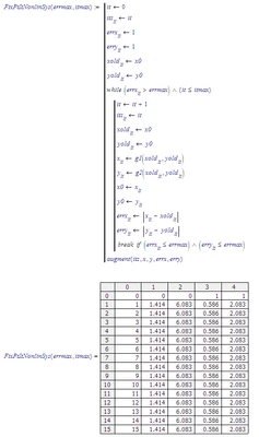

That gives:
Not quite the result you expected. But at least the error is gone.
Now you find out why nothing is happening after the first iteration.

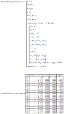

July 23, 2020

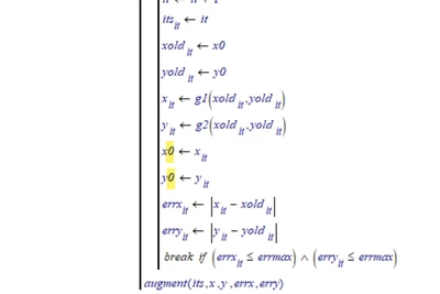

o != 0
July 23, 2020
I was afraid of making that error, and I still did.
But correcting that doesn't help:
