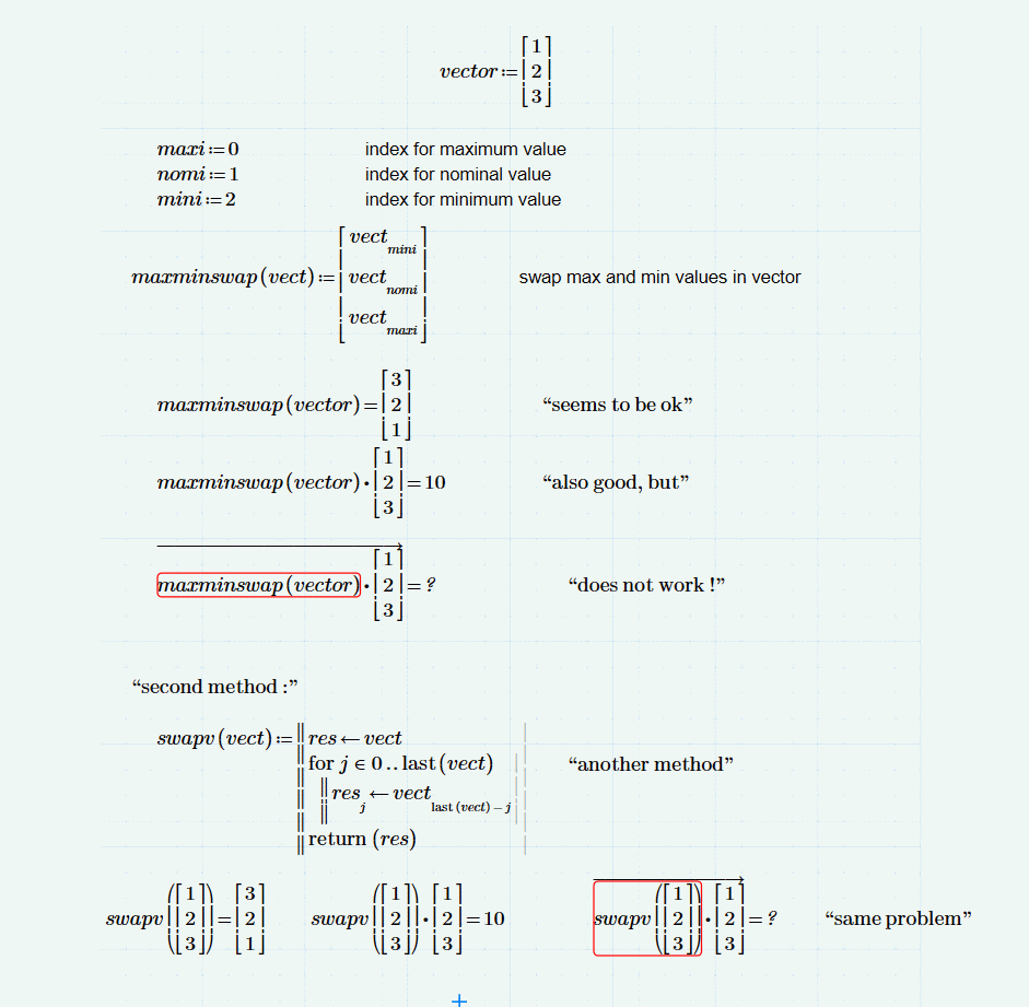

I want to flip a vector, that means reverse the sequence of its elements for example (1,2,3)  -->  (3,2,1). I tried several methods, none works really.
The problem is, the result vector seems to be ok, but if I use it in other expressions together with the vectorize operator MathCad says always this value has to be a vector.
I am using Prime 3.0. Thanks

sorry didn't know this function. but the problem stays the same. The only workaround I found by now is to assign a variable and then use the vectorize operation. Seems that the vectorize operator somehow does not work on functions, which have a vector as result?

"vectorize" means "take the vectors under the arrow apart and do this operation on each element, leave the result in a vector with the same number of elements.."
When you vectorize your function, Mathcad takes the first element of the vector and tries to sort it into three parts--it can't
Besides, there's a command "reverse"

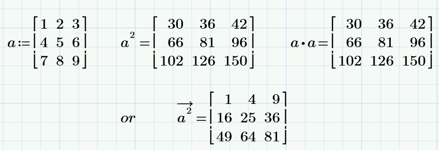

"vectorize" means
One good example
