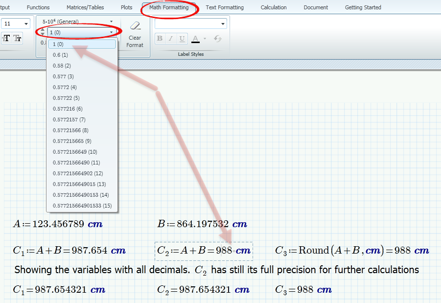

Do you really want to round up the result an assign Np an integer value or would you rather simply want the result to be DISPLAYED as an integer?
In the latter case you may resort to the Math formatting ribbon and select the appropriate Display precison.
