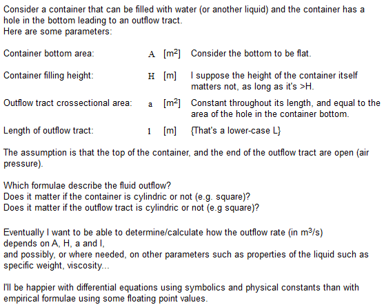

Here's a problem that I'd like to solve, using Mathcad, but I don't know where to start because I lack the proper domain knowledge. Is there anyone who can help me on the way?
Thanks in advance for any help.

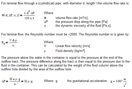

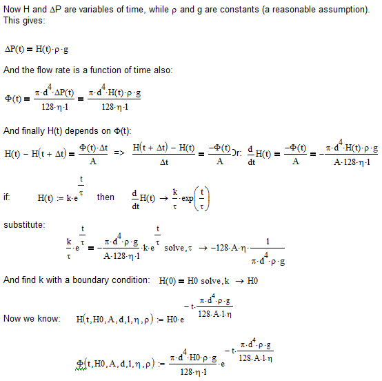

Hi Richard,
I started off from your first attachment and built this:
This should do it.
