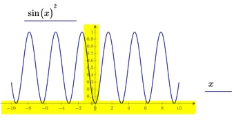

Is there still no way to set the plot font size in mathcad Prime 9
10 replies
Apr 11, 2023 4:14 PM UTC
Unfortunately - no.
PTC seems to think that the plot 2D desaster was solved when they introduced the badly implemented third party chart component with its many drawbacks (slow, not unit-aware, does not scale which is a big problem on 4K screens with a higher windows zoom setting, ...).
It looks like they don't intend to improve Primes native plots.

Thanks for the update. I had originally just been asking about native plots.
But when you say get used to using the Chart Component, I then hoped Prime 9 might be able to adjust the axes font size. I see it also does not.

I assumed that @CDMAcat  was talking about the axis scaling of Primes native 2D plots
CDMAcat3-NewcomerAuthor
3-Newcomer
Apr 11, 2023 5:23 PM UTC
Yes, that is exactly the question I have. I should have put that in the subject line
