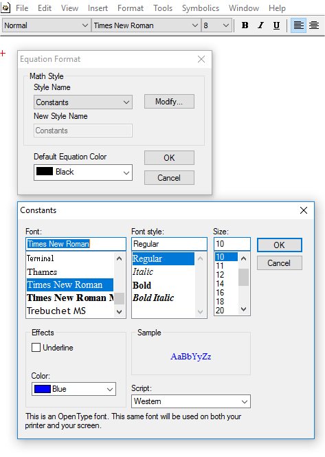

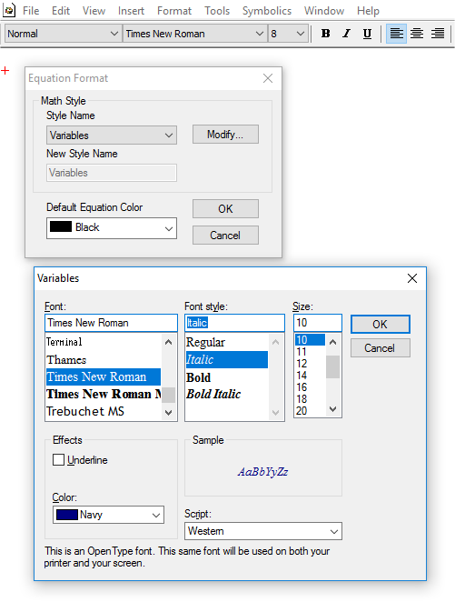

Make sure that you set up the normal.mct (template) with fonts (for text, variables and constants, etc) that are supported on all your windows versions, and use that same normal.mct with each installation of Mathcad.

You should give precise indications with some images of the panels to be opened. The printer is unique, but I can not modify anything. Within the same worksheet I need different fonts.

I assumed, considering that you installed Mathcad on those machines, you'd be capable of finding out which fonts are available on all your machines.
Screen shots? How about:
