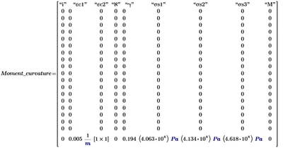

I expect to obtain a matrix with multiple rows (i.e., 10 rows), where each row corresponds to the final iteration of strains (εc1, εc2), which have to iterate until the condition of equation (4.3) N<0 is true, and contains:
  • iteration index
  • concrete strains εc1, εc2
  • curvature א
  • steel stresses
  • bending moment M
However, Mathcad returns an empty table only, even though:
  • the outer loop is defined as for i ∈ 1..n with n = 20
  • the loop body is executed
  • no errors are reported
I understand that my script is one of the few possible ways to solve the issue; thus, with this regard, my questions arose:
  • How can I use a WHILE loop for my iteration until the condition of equation (4.3), N<0, is true, in the correct way to substitute the found value of εc2, which led to the condition of equation (4.3), N<0, in Mathcad Prime (if it is a more straightforward way to mess with)?
  • What are my mistakes that lead to Mathcad returning only the empty expression of a 20x9 matrix instead of the full loop result?

You have the assignments to Moment_curvature[i,1  through [i,9 outside of the for loop that iterates over i. So at that point i is a constant. Only the last row of the Moment_curvature matrix gets filled. See here:
I guess you must move the assignments upwards in the algorithm, probably at the end of the For loop.
