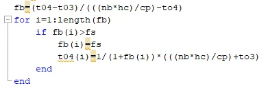

Hi, how do I write this for loop in MathCad?
My fb is (similar to the first line of code)
**Side note: I need to evaluate these values as rc goes from 2-60.

The matlab code appears to use fb as an array, rather than a function. If you do need a FOR loop in Mathcad, you need to make sure that you work with arrays.
If you:
- Explain what the matlab code is supposed to do, and
- Attach your Mathcad file
We may be able to help you.

The matlab code says that if fb > fst, then we need to set fb=fst and calculate T04 instead of taking the T04 we were given. If fb<fst than we keep the T04 we were given and can continue to calculate for P04.
