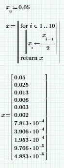

I am attempting to write my first For Loop. I have a vector of values, i=0 to 10. x0 = 0.05. x1 = x0/2. x2 = x1/2, etc. I cannot seem to find any way of doing this. I have tried this, below, but it doesn't work. Please help!
DJFAnswer
June 4, 2020
try it like this:

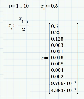

Welcome.
1st of all: You should always attach your worksheet, not just a picture.
2. The definition of i:=1..10 already is a FOR-loop.
This is how it works:
Another way is:
(This was done in a previous version of Mathcad, but should work in Prime just the same)
DJF16-PearlAnswer
June 4, 2020
try it like this:
