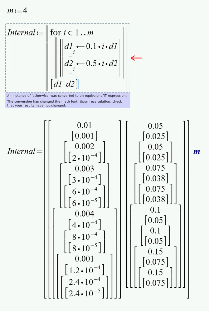

The problem is that d1 and d2 are vectors within the loop.  At each iteration, their next value is the whole of the current value ... which is a vector.  Consequently, Interval creates a deeply nested vector of vectors and, hence, the "must be a scalar" error.
You could try initializing d1 and d2 to be single-element vectors and then using d1i-1 and d2i-1 within the loop; as i runs from 1..n, and your ORIGIN=0, this should pick up the first values of d1 and d2, and give you the desired results.

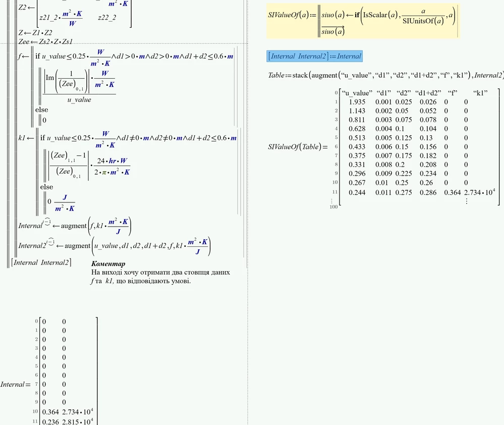

It looks pretty cool and meets my requirements. But, to be frank, I would like to sort solutions which meet my restrictions and not see all the dozens of "0" values in the final INTERNAL matrix.

Werner's version of your program returns a lot of zeros because that's what the conditionals select.  I've modified Werner's program to return u_value, d1, d2, and d1+d2 in addition to f and k1 to allow inspection of the values.

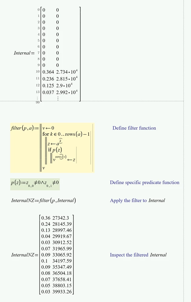

Do you want the program to return Internal with the zeros and then remove them, or do you want it not to add the zero f and k values?
One external method is to apply a filter function to Internal that selects for f and k1 both being non-zero.   There do not appear to be many non-zero values.  Is that what you would expect?
