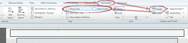

formatting Mathcad header and footer
I have accidently pushed something while save matchad and this header and footer appeared and I cannot seem to get rid of it

Aug 3, 2025 8:14 PM UTC
Go to ribbon "Document", choose "Header" and click (deselect) the options "Show Grid" and also "Show Frame"
From your screenshot it looks like you accidentally turned on these two options while you had selected the header area (maybe by double clicking) and actually wanted the options to take effect for the worksheet area.
"Show Grid" affects both header and footer. that's the reason why you see the grid also in the footer area. Turn if off for the header and it also will be turned off for the footer.
Aug 5, 2025 1:03 AM UTC
The sheet you posted does not show the effect seen in your screenshot - did you post the correct file in question.
Did you try to turn off "Show Grid" and "Show Frame" in the header area as suggested above?
