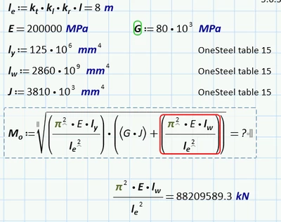

Formula for buckling error
 can somebody tell me why this is saying units are not compatible, it works when I take it out and do it by itself??
Thank you

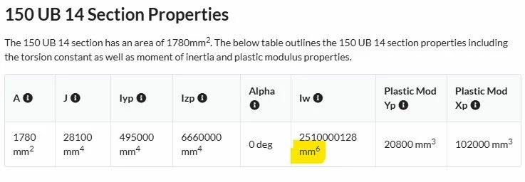

The units for Iw are mm^6 not mm^4
Cheers

Not all your terms have the same units.:
Why is there a green circle around G?
Cheers
Terry
7-Bedrock
Aug 2, 2025 11:59 AM UTC
Thanks, Terry, yes it's working now!!!!!
