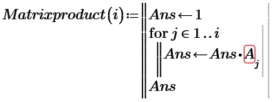

I have an issue with the definition of the Prime user function.
There are several matrices 2*2 in the general case ( the exact matrix number oscillates from 1 to 4-5-6).
Each matrix has a lowercase index (connected to the data from the parameters table). I want to define user function to make matrix production. Due to my modest coding skills, I have no results to describe as appropriate. The relevant search on the forum gave some material but didn't seem to help.
https://community.ptc.com/t5/Mathcad/Production-of-Matrices-Elements/m-p/676964
In the attachment, there is my problem sample, performed in Prime 10.0.0
Any assistance would be appreciated!

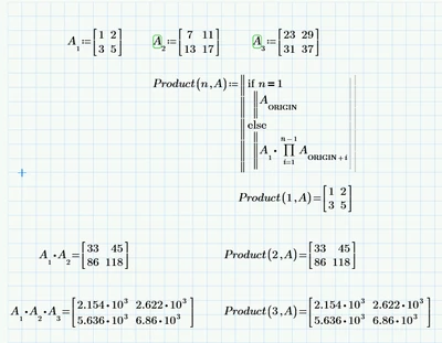

This also works:
7 replies
23-Emerald V

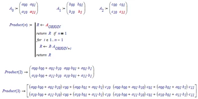

Try this:

@LucMeekes
Thanks, but this is beyond my level of understanding...🙈
By the way, paid attention to the similarity to the IF condition in my second reply...

LucMeekes23-Emerald VAnswer
23-Emerald V
This also works:
Ivan_Pat13-AquamarineAuthor
@LucMeekes Thank you, it helped!
I modified your code with the IF condition a little for A=1.
