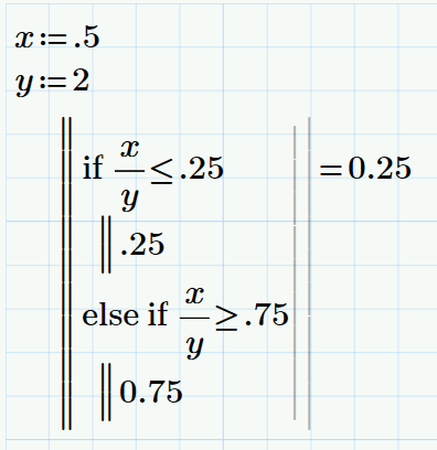

For ease of asking this question I have a formulas solution is bound by upper and lower values but can be anywhere inbetween the upper and lower values. How can I write that as programming statement. So far this is what I have :
If I were to change "x" variable to  equal "1", the formulas solution (x/y) would equal "0.5", I would like the program to spit out that answer as well.
Thanks for the help, hope to reciprocate sometime!

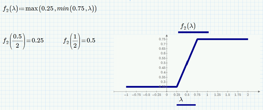

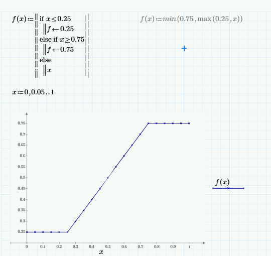

Both of these should set upper & lower limits
Hope this helps
Andy

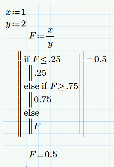

jmenier1-VisitorAuthor
January 19, 2017
You the man! I appreciate your help, this is what I did incase you were wondering...

Here is another one:
