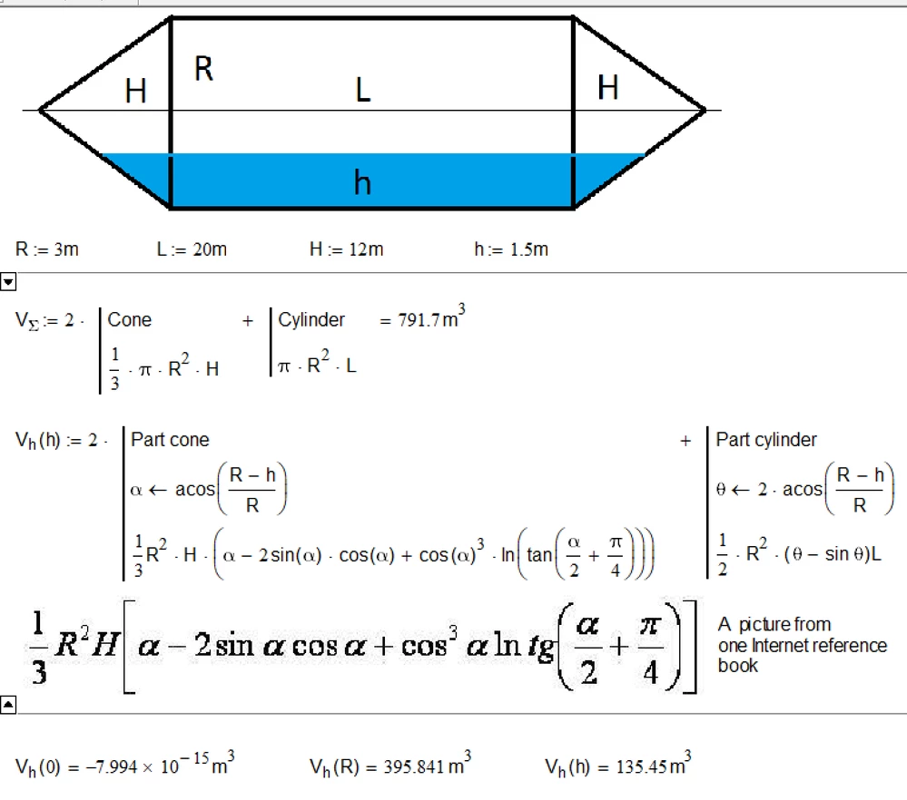

Formulas in reference books and in Mathcad, Maple etc
There is no Polls now in this community,
but I ask you
what we must do now
1. Change formulas in references books
2. Change tools in Mathcad, Maple etc
3. Nothimg
4. Others
See the picture please

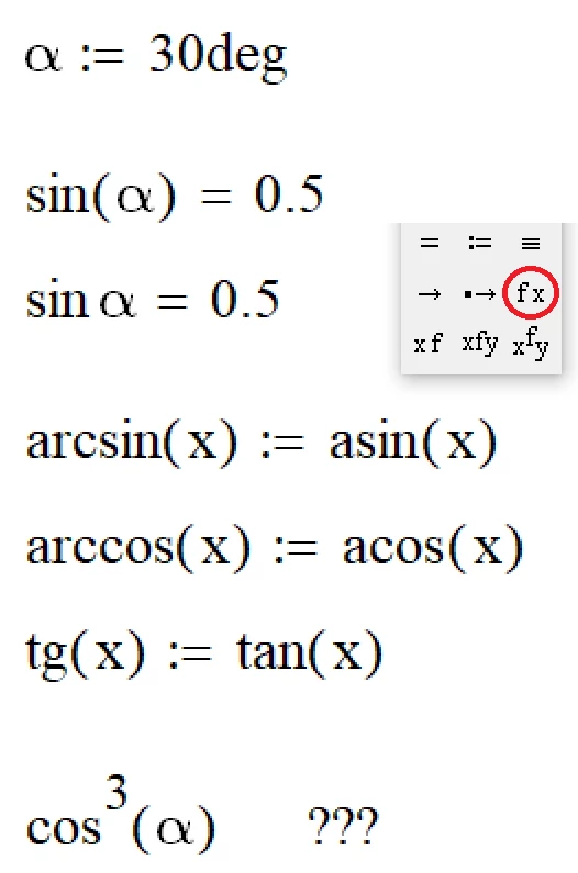

Part of solution

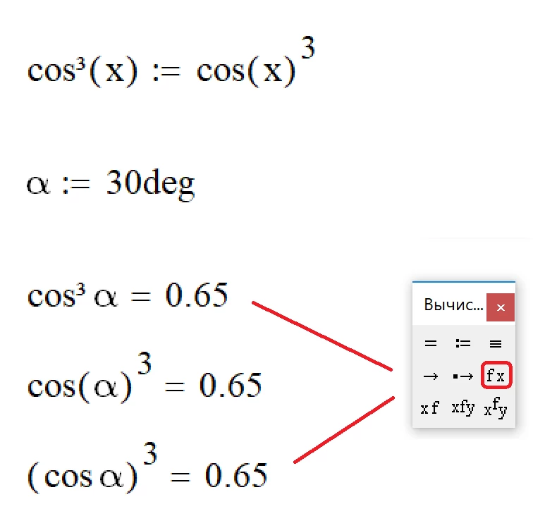

Use Alt+0179
December 14, 2017
Yes, it is for us - for elite of Mathcad user!
