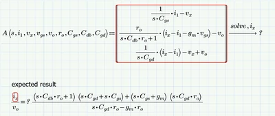

I would like to get the transfer function from a set of equations that I got from KCL and KVL.
I am not sure how to do it in Mathcad (Prime 5).
From here, this is what I tried.

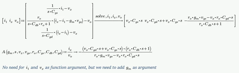

You have three equations so you should solve for three variables.
I am not sure what exactly you are looking for - could it be something like this:
Worksheet in Prime 5 format attached.

sorry I was not clear.
i1 and vx should be eliminated.
EDIT: I added vx

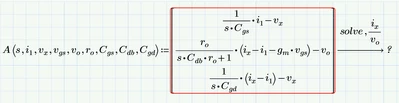

bmulyanto1-VisitorAuthor
Dec 12, 2020 6:31 PM UTC
Thanks. I got it closer.
Is there a way to make the numerator into the form like what I posted in my EDIT?

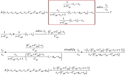

Dec 12, 2020 6:55 PM UTC
I don't think so. We have very few possibilities to influence the representation of the result of symbolic evaluations in Prime.
You may try to play around with the few keywords we have at hand, but I don't think that you will succeed
Instead of "collect, v.x" you should rather use "simplify" to let Prime cancel v.x
"factor" alone will also do this job as it applies implicit simplification.
