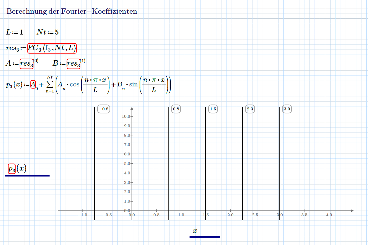

I have created a seperat worksheet without the indizes "3" and the error occured again -see attached pdf.

November 3, 2016
You should at least have told us what exactly the error message is you get at the definition of res.3
The reason for the error seems to be that you integrate from -1 to 1, but your function f.3 is not defined in the range -1 to -3/4!
It would be more versatile if you rewrite your FC function with two arguments for the start and end of integration interval instead of providing just L. That way you are more flexible in defining the functions you wish to analyze.

November 3, 2016
Hi Volker
f3 is not well defined for mathcad Prime. Using the step function, everything works.
November 3, 2016
No, it doesn't. You set the interval -1 to -3/4 to zero that way, but there should be part of a parabola here!
So you are analyzing a different signal as was intended. There should be a parabola in the range 1 <x< 1.5 but you have just zero there! I am talking about the fourier-row here, not the signal you defined
You see the error even in your coarse approximation with five sines.

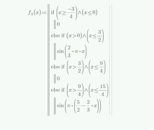

November 3, 2016
I used the f3 function defined by Volker  at the end of his pdf file, here reported below:
