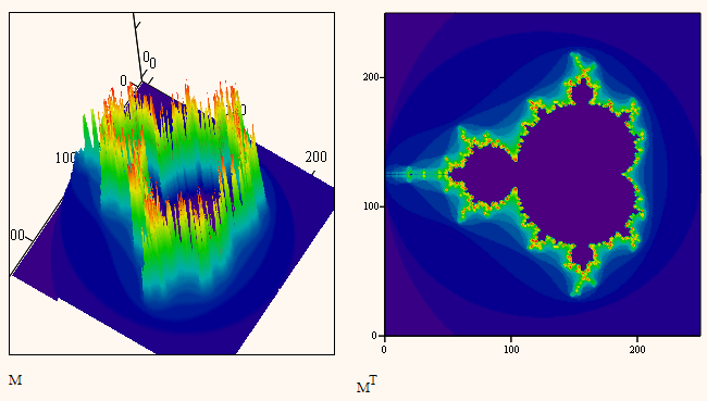

Hello Ioana, I did everything I could do. With the data available, in fact, I could not do much. In the picture I give you some suggestions.
Greetings
FM

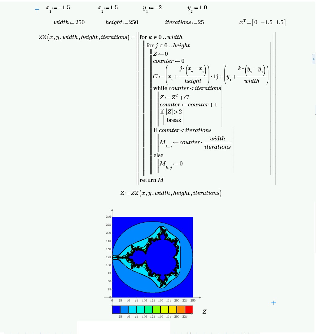

This Mathcad Prime worksheet can be found in attachment as a PDF document for a preview (for those who have trouble with opening Prime 3.1 worksheet).
See please Video Link : 2426
> I would like to send this data to Creo,
Which data?? The sheet you posted is faulty and unfinished. It does not create any data!

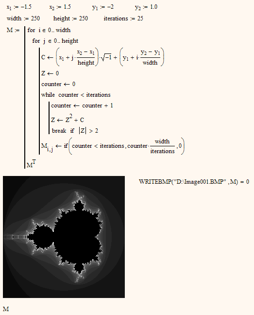

Here is, following the lines you provided, a solution in Mathcad 15. In Mathcad 15 we have a picture operator and so we can immediately see the result of our calculation (as you provide only one value per point its just  gray-scale image.
In Prime you can just save the image using the WRITEBMP command (as shown in the picture) and display it externally.
The Matrix with the values can be exported in a couple of different formats, if this helps importing them in Creo.
In Mathcad 15 you could also create a 3D-Plot or a Contour-Plot using the very same data matrix and color it using a colormap of your choice.

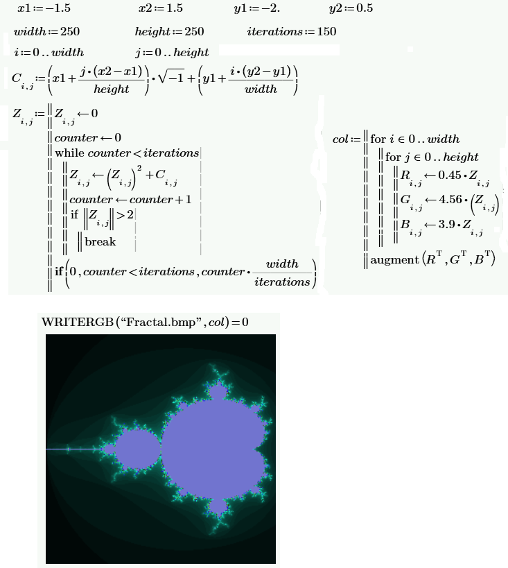

Initially, I have been inserting by mistake the wrong worksheet. Here is the one I meant, sorry for all the trouble.
One more thing: In order to send it to Creo I would need Prime 3.1, and moving from MC15 to Prime can be harsh sometimes, since some of the old functionalities have changed and get lost during conversion. I will try to see if it works with bmp first.

>Lookup WRITEEXCEL, WRITECSV, WRITEBIN or WRITEPRN in the help.
...And WRITERGB function.

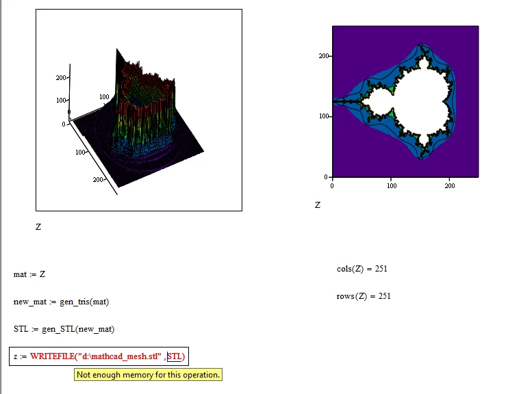

In attachment can be found the worksheet that record matrix data into STL file format as a 3D model, which can easily be used later in Creo Parametric. But I have at the last moment of calculation when writing STL file the following error - "Not enough memory for this operation". I test it on Win 8.1 x64 with 8Gb of RAM. Can someone please check it?
P.S. For a viewing STL file format you can easily use "Online STL viewer", here: Free online STL viewer
Same Problem: Windows 10 64-bit, 8GB.

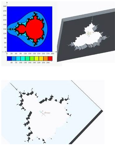

Last week I also continued to play with Mathcad and Creo in order to create a 3D fractal model to be 3D printed later.
It may sound harsh to transform a matrix of 300 rows into a 3D-converted readable, modifiable graph but not quite as harsh as it really is. And interesting!
There were many ideas, one of them being to make a matrix of 3 strings with those strings containing some informational values from the given function, another one was to write a .stl custom function,  and other ideas such as these 2 that were driven by the Community responses to my proposed question:

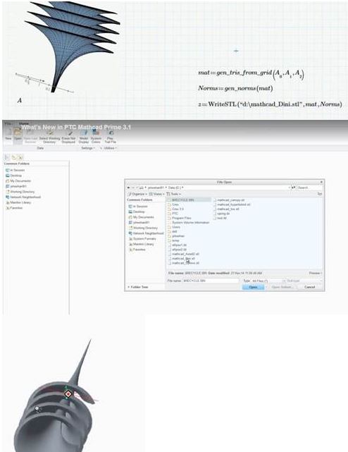

After trying to create a STL file from Mathcad Prime 3.1 that I saw to be possible, according to this Demo:
http://www.ptc.com/video?id=4002771978001&account=Demos
I found out that this customized function would require a .dll with background programming so I skipped directly to this life saver tool that converts 2D images in 3D objects, aka .stl files.
http://app.selva3d.com/transform (5 free trials)
After transforming it, I still had some more steps to do - to make it solid, in order to extrude it afterwards.
Some of the steps, if anyone ever interested, can be found here: https://www.youtube.com/watch?v=ho-t5OgEbJY

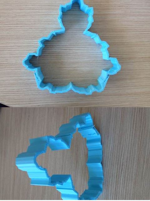

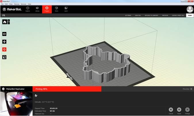

which lead to 4.JPG that is set at a level that contains not too many details, because otherwise, when printing, it would be very messy and many of those details would be lost anyway.

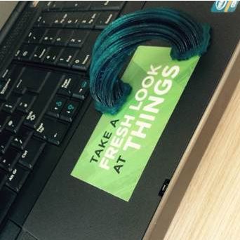

After some finishing strokes, I moved the part through MakerBot, that transformed as you may now see below: 5.JPG
And the tangible result:
Tada!!!

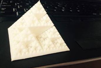

I have also printed 2 of them the other week:
This one http://www.thingiverse.com/thing:1123004
And this one:
