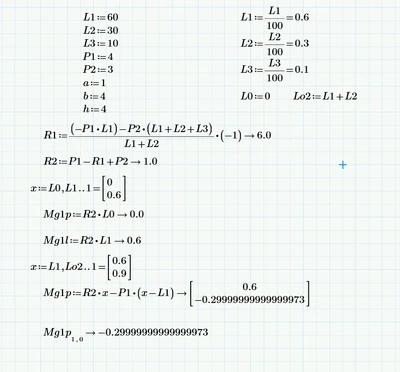

Fractional form, doesn't work correctly
I saw other solutions but they are not helpful   in my situation.
Anyone have  idea how to convert  my  result?

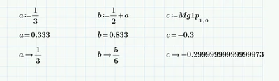

I need -0.29999999999973  show in fractional form.
I checked settings, other forums but didnt find any solution.
It works really strange, I have latest version of Mathcad  Prime 6.0

Note that if you want(ed) the symbolic processor to present c as 3/10, you have bad luck. The symbolic processor works exact.

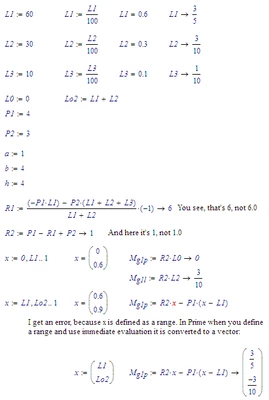

Something that may help tremendously is if you omit the immediate evaluation of your definitions:
So get rid of the "="-es that lead to 0.6, 0.3, 0.1, [0,0.6] and [0.6, 0.9]  respectively.

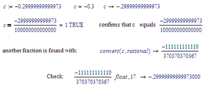

23-Emerald V
Jun 8, 2020 3:47 PM UTC
In case you're wondering:
