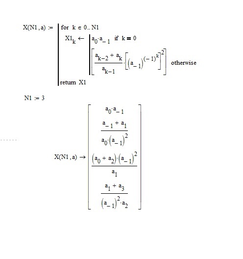

     Is there a way to solve X0, X1, X2, X3  with a Program Function ?

If I understand correctly, you want this result.

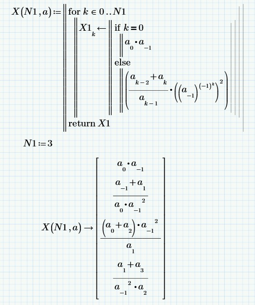

-MFra-21-Topaz IIAnswer
May 19, 2016

Many thanks for your time and help, F.M. .  Could you attach .xmcd file for mathcad 14 ?

May 19, 2016
The file is attached.

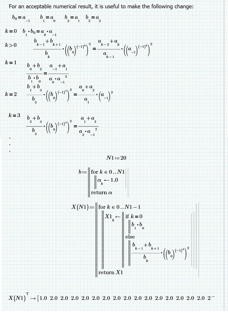

I would like to point out that the result has only symbolic meaning. To get a numerical result, you should do so:

Hello Everyone again,
and
   Solve, X[0, X[1, X[2, X[3 symbolically ?
