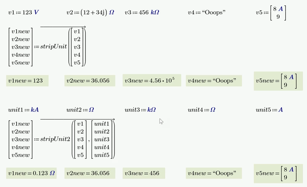

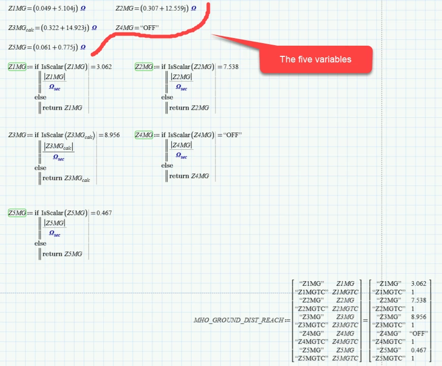

I'm trying to determine if five variables are scalars or strings for installation into a unitless matrix for future use.  Shown are five separate IF expressions.  Is there a single function to condense the five IF statements into?
Werner_EAnswer
Feb 11, 2026 4:09 PM UTC
How about
or with more control concerning the unit
Usage:
Werner_E25-Diamond IAnswer
How about
Usage:
Feb 11, 2026 4:16 PM UTC
Thanks!  I will give the above a try.
