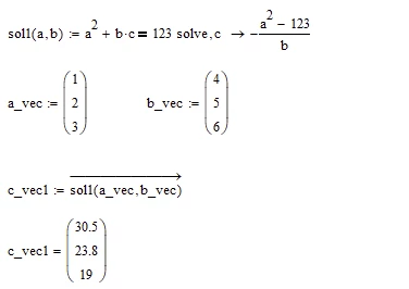

Here just a shot in the blue
Lets assume you want to solve the equation (you can't solve a "function"!)
for c, input values are a and b and you want to solve it for a couple of a- and b- values which you provide as vectors.
One way could be to symbolically solve the equation and turn the result into a function sol1( ) of a and b.
Then you call that function with the vectors as arguments (you should use vectorization when you do so).
Another way is to use the numeric root function in a similar way
