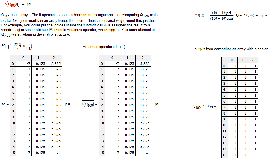

Hi everybody:
I have got a problem with MathCad. When I define a function without If statement, everything is fine. However, as you can see from attached MathCad file, with adding if statement in my function, an error appers that "this value must be scalar"
Any idea why this happens. I have attached the file.
Thank you

See image below
Stuart

Thank you so much. It works now
