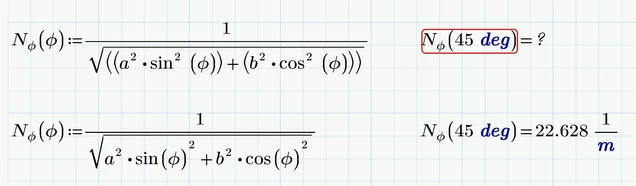

I defined a function depending on one variable. Then I used the range operator for the value which my function depends on. I want to call out the max value of the function based on the range variables. The "max" command doesn't work. I think something is wrong with the equation, since the function can't be evaluated when I type the angle in parenthesis.
Please, take a look ath the attached sheet.

The problem is when you define your function.
You cannot use the convenient convention to write sin^2(x) for sin(x)^2.
If you highlight your function definition and look closely, you  will see an implicit multiplication dot between sin^2 and the opening parenthesis. Obviously that can't work.
The other parenthesis you typed aren't wrong, but not necessary
You have to type it the other way to make it work:
To find the max value you shouldn't use a range but rather a vector of angles
Here the max-value is the one at angle zero, for b>a it would be at 90 degree.

Thank you, it works.
