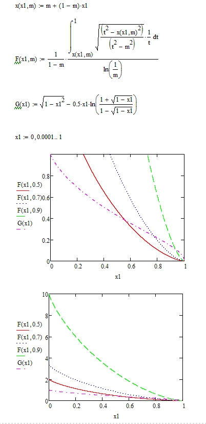

Something along these lines?
Anousheh1-VisitorAuthor
Hi Luc,
Thanks very much.
For some reason, the worksheet is not working.
and x=m+(1-m)x1 (you put it as x)
and the graph should be against x1.
and G(x1) is the correct one not G(x).
Could you please double check. I used the "substitute" symbolic operator and nothing happens. No error messages.
Anousheh
23-Emerald V
Press F9 after opening the sheet. It doesn't calculate automatically.
In addition, for speeding up, you may want to set TOL:=0.001 at the top of the sheet.
And you can have the range of x as x:=0.001,0.002...1
The x or x1 doesn't matter. They're just parameters.

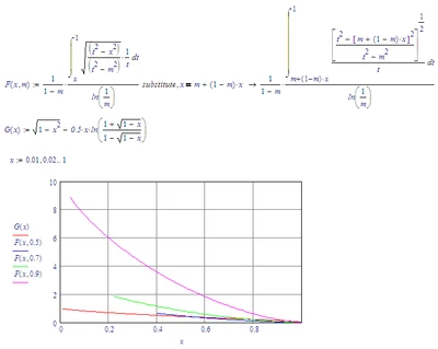

Hi Vladimir,
Thank you so much. Would you please upload the file? I get G(x1) graph and F(x1,0.5) not showing up with no error message.
And one question: how the value of m (0.5) is incorporated into G(x1)?

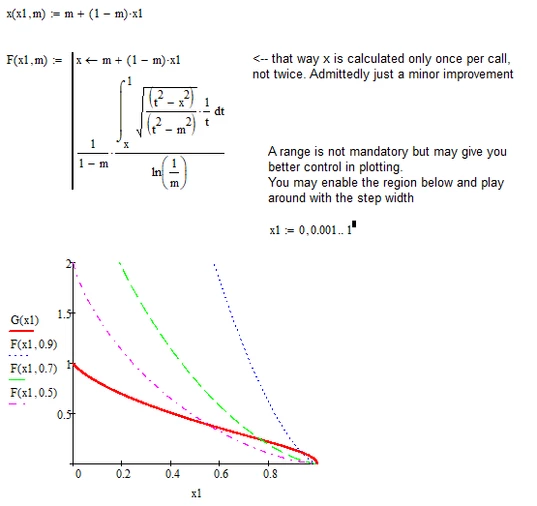

Here are my 2 cents:
MC15 worksheet attached.
BTW, I guess Lucs worksheet will work OK, if you turn on auto-calculation. Luc has it usually turned off and so you have to manually recalculate (Ctrl-F9) after every change.
Here is another way to deal with those nested functions:
