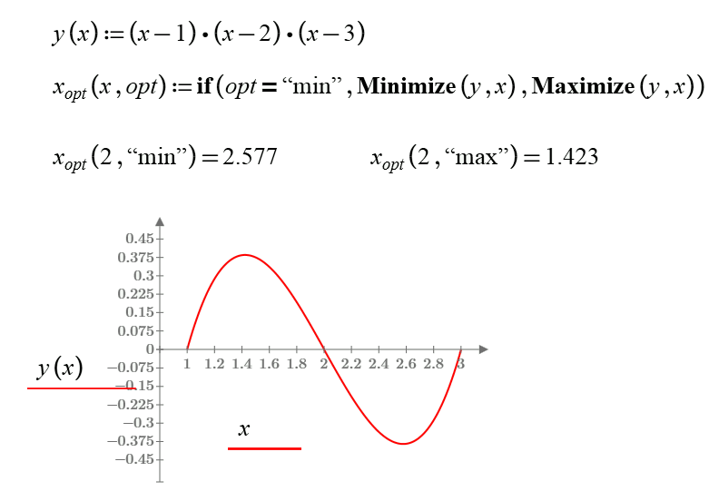

I couldn't understand why the function with condition statement in this case IF statement as shown below dose not work properly
Is this right way ? or I am making some mistake.

On the other hand if i just use Maximize or Minimize manually according to the condition with out any condition statement it works correctly
May 9, 2015 3:43 AM UTC
I think it is a bug in Mathcad 15. In Prime OK:

It is not a bug. It is one methodology of the soft.
If(a=b, m, kg) - a bug in Mathcad 15 but not in Prime.
Can you use in your case y(x) or -y(x) for the finding min or max?
