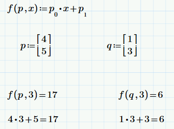

Vectors are indexed starting at zero.  To address the first element in a vector requires a subscript using the keystroke "[".
Your sheet then will look as:
I have made the function use both p (a vector) and x.  You can put any vector (with at least two elements) into the function, and any value for x.
