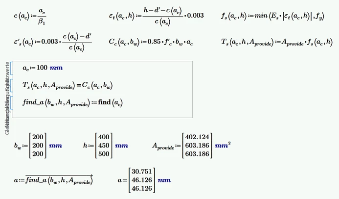

Set up the calculation just for single values, turn them into functions and call them vectorized.
Maybe that way:

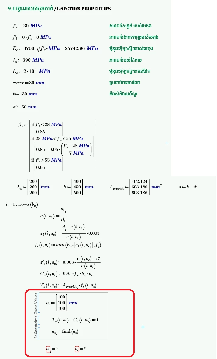

Please (also) attach your worksheet. You may have to zip it first.
A serious bug in this forum often prevents from attaching a mathcad file. In Windows Explorer click with the right-mouse button on the mathcad file and select 'Send to' -> 'Compressed (zipped) folder'. The resulting .zip file can be attached.
March 13, 2018
Dear Sir,
Please see attachment
Thank u
Werner_E25-Diamond IAnswer
March 13, 2018
Maybe that way:
