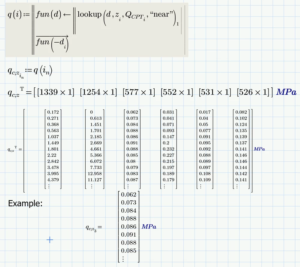

I guess that "lookup" is more suitable for your needs than "match".
See if the attached helps. It was necessary to use " -d " because the values in vectors d are positive, but the values in the vectors z are negative!

d is the length while z is the depth I want these two values to be always associated with each other and then connected them to Q values

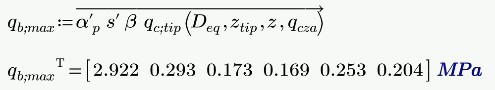

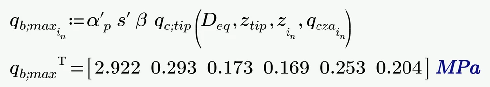

To achieve what you possibly try to do, you may use
Here looping through the values in the z and q.cza vectors is done using the range variable i.n.
But you can also do it without that range variable. With the following approach the looping is achieved using vectorization:

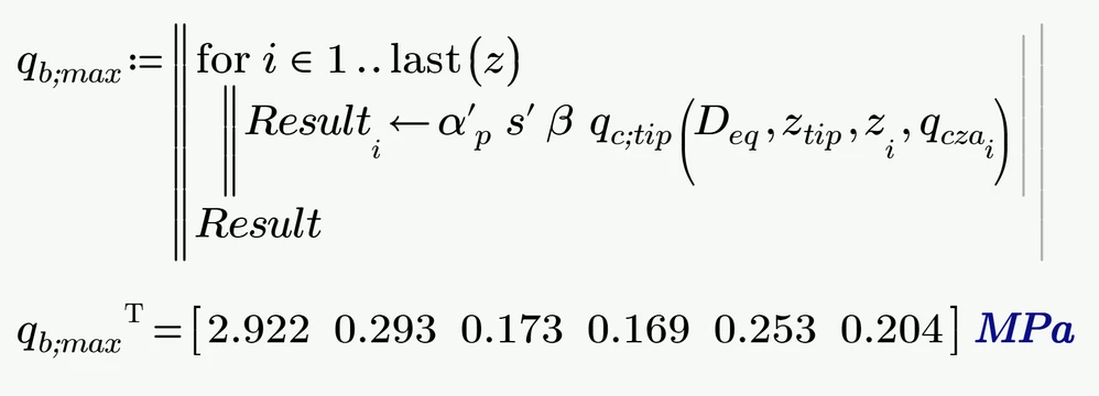

A third approach uses an explicit programmed for-loop to do the job. A bit more space consuming but maybe also a bit clearer to read and understand:
