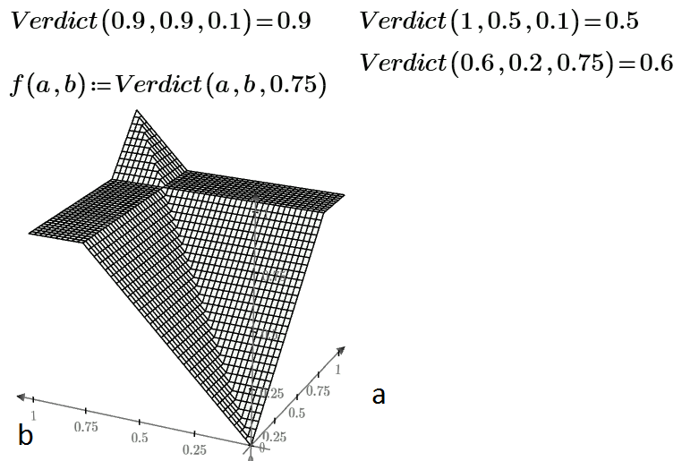

One question. What is the function Verdict not fot 3 but for n (12 for example) jorors?
24 replies
Nov 27, 2014 10:28 AM UTC

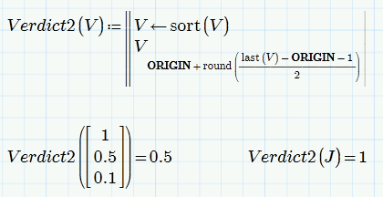

If I understand properly you want to make your inputs "vote".
Here is an example of verdict function for 12 voters, with votes in a vector. I don't like it very much, because you have to re-write the function when you change the number of voters (can someone adapt it to make a version that will make it work with any number of voters in a single function ?), but I think it should be reasonably straightforward to adapt.
Nov 27, 2014 11:15 AM UTC
I haven't spent much time on it, but wouldn't the following to the job as well?
Nov 27, 2014 11:50 AM UTC
Awesome ! I don't think it is possible to make any simpler that that !
Except that it doesn't look for the right value when there is an even number of voters, so I woulddrop the "-1" in the index.

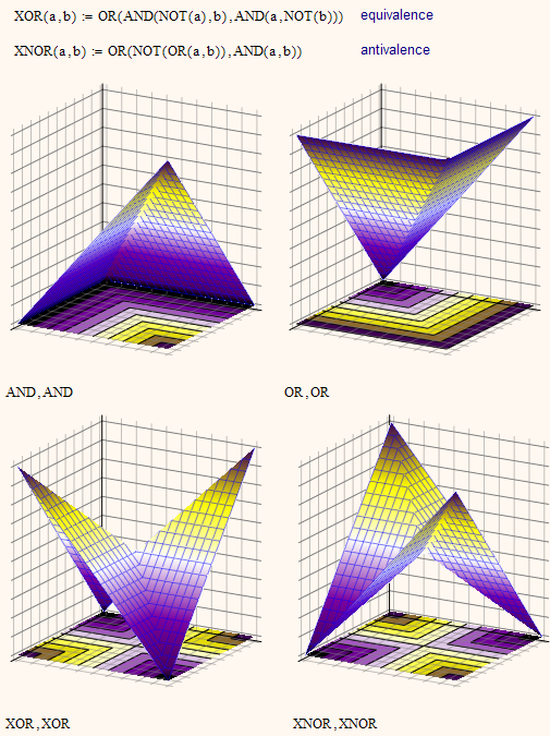

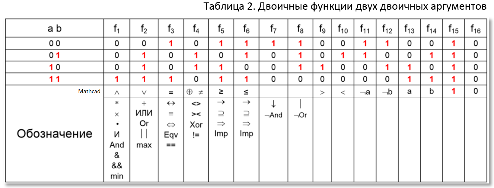

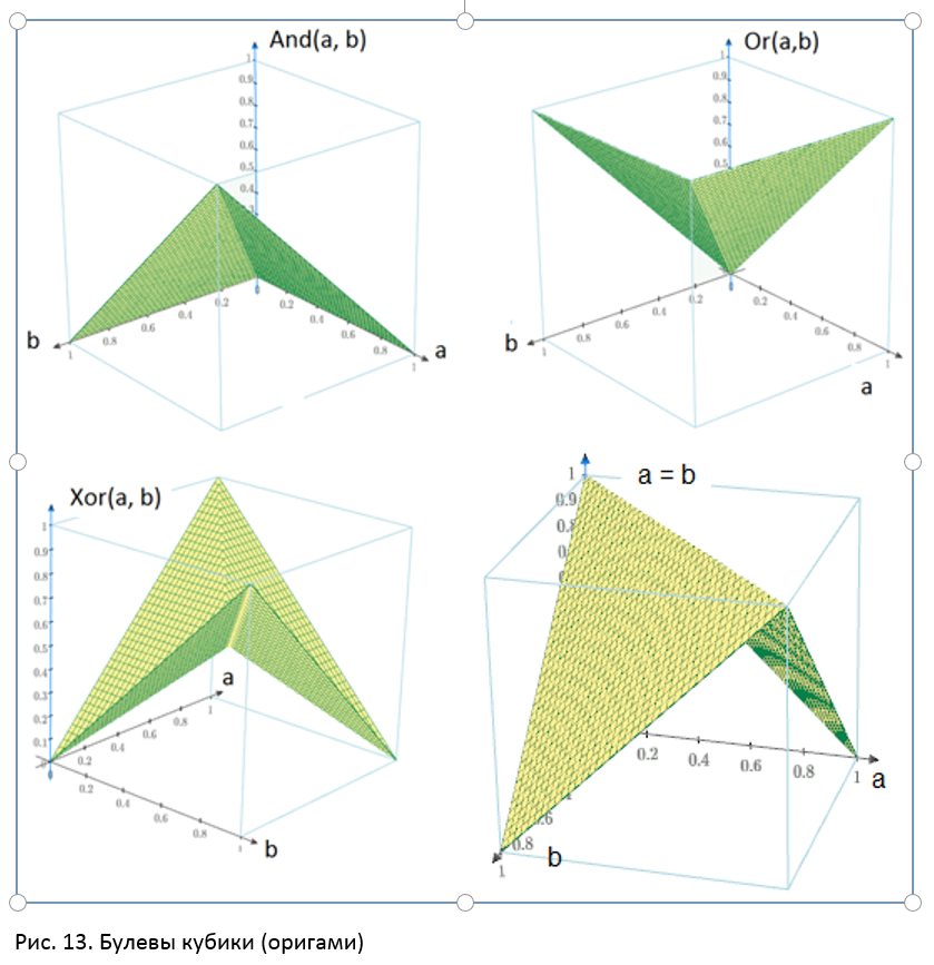

The question is!
I am writing the article "Boolean cubics or origami".
One picture from it:
1. Are Xor and Eqv (=) cubics correct for fuzzy logic?
2. Can we plot others fuzzy logic cubics (create origami) using this table?
Nov 28, 2014 2:42 PM UTC
Equivalance seems to be wrong. Equivalence (XNOR) is the neagtion of antivalence (XOR).
Why not? You can create all with combinations of AND, OR and NOT.
Nov 28, 2014 3:05 PM UTC
Thanks!
But sorry - XOR is Not(Equal), and Equal(0.5, 0.5)=1, not 0.5. Equal(a, b):= 1-| a-b|.
And second.
We can create all (17!) function by using only one, not three.

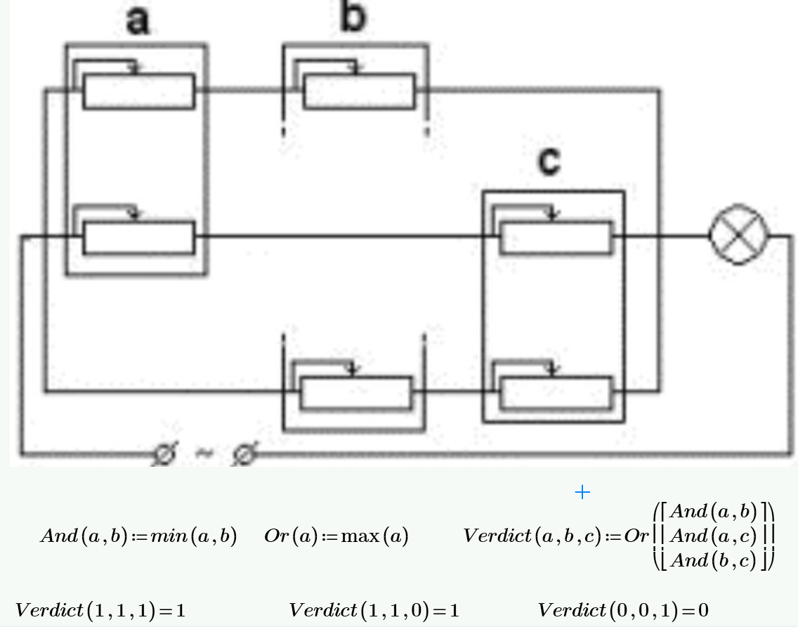

Dec 3, 2014 6:28 AM UTC
It is said that in the US the electric chair brought into lethal effect several people. In this case, the present switch is operated by only one person. Other participants include the execution of this fake breakers. And no one knows where the fake, and where the real switch. This procedure is somewhat hypocritical allows each such executioner think that not he but someone else was the cause of death. If all of these circuit breakers replaced by rheostats (See below. Fig. 14), a smoothly varying voltage, death can be replaced by non-lethal punishment: sentenced offender will receive an electric shock (strong or weak), but remain alive.
Is it true?
Or more correct question:
It is true - 1
It is more truethan false - 0.75
50-50
It is more false than true - 0.25
It is false - 0
