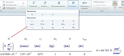

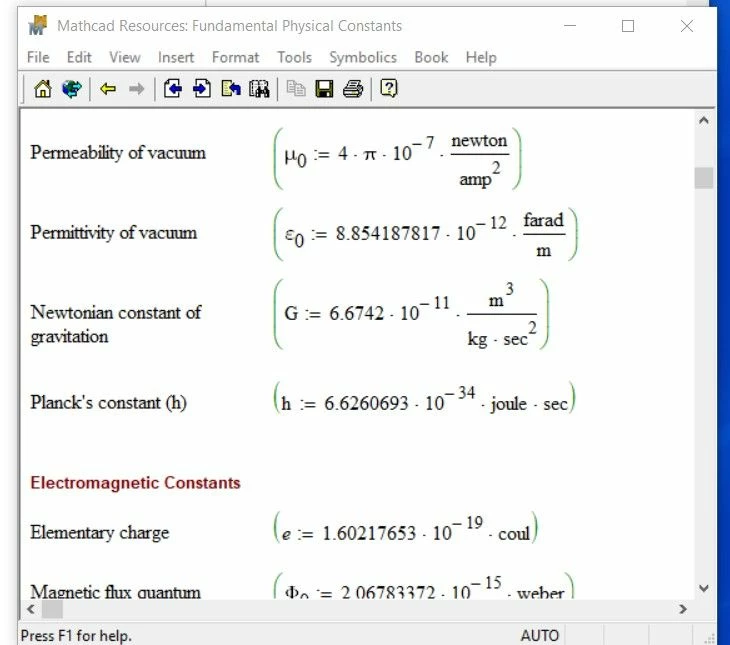

G as built-in constant
What more constants will be good to have here?
G is available in M15.  Is it not there in Prime?  (I don't have Prime).

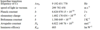

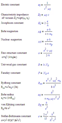

First off, the following need to be defined as natural constants.
Note that the values given are EXACT, by definition as of May last year:
From these, many other natural constants can be defined, as well as the SI units.
For more information see here: https://www.bipm.org/utils/common/pdf/si-brochure/SI-Brochure-9-EN.pdf
23-Emerald V

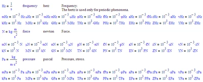

So in  (real) Mathcad I can do this:
Subsequently I can define:
and so on...

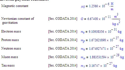

From there I can go:
et cetera...

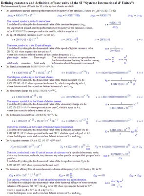

Then after defining:
we can:
I have not found a way to do the first step in Prime, so I haven't bothered to try the rest.
