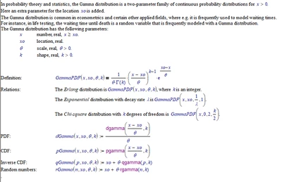

This is what I built long time ago:
The function names in purple are the built-in functions of Mathcad.
