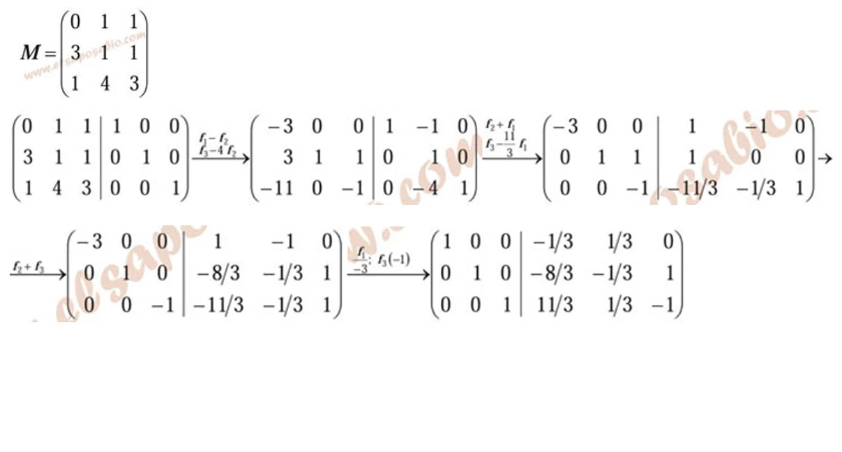

I try in Mathcad to build  Gauss-Jordan method for obtaining the inverse matrix but it looks quite difficult.
It is closed to Jordan elimination method, but on the right side we consider initially (in the augmented matrix) an unit matrix. Did anyone build this method in Mathcad?
