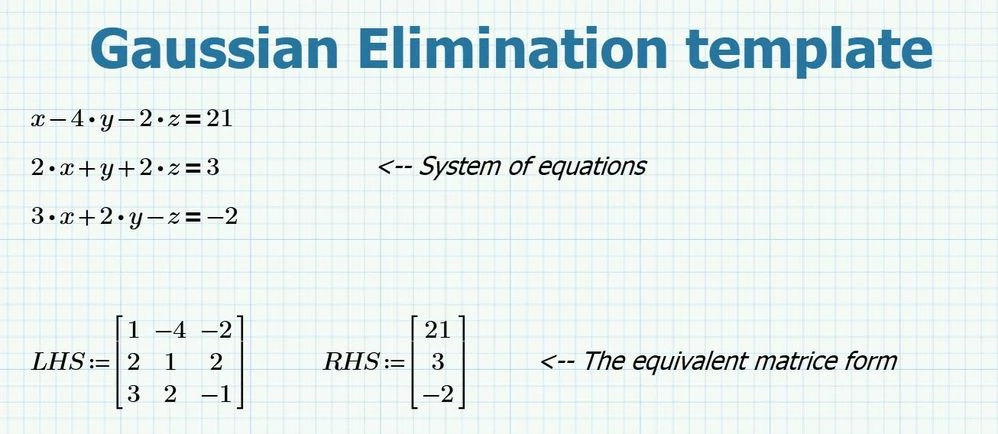

Hello guys,
I'm new into Mathcad Prime and this community, so please bear with me.
I'm trying to make a template to solve systems of linear equations with the Gaussion Elimination method.
I would like to know, if anyone in this community has a template to solve any kind equation systems with Gaussian Elimination?
I have attached a file with a system of equations, that I would like to solve with such template.

So you are not interested in the simple solution of such system, right? There would be a lot of different ways you could achieve that in Mathcad. You want Mathcad to show you step by step how to do it manually using the Gauß algorithm, right?
Mathcad is not made for showing you the calculation steps but rather will give you the final result only. I gues with some programming it would be possible to achieve what you are looking for, but then - why? There are websites which will do exctly that, no need to reinvent the wheel, I guess. E.g. a German one is http://www.arndt-bruenner.de/mathe/scripts/gleichungssysteme.htm A possible outout of that site is in the attached file.

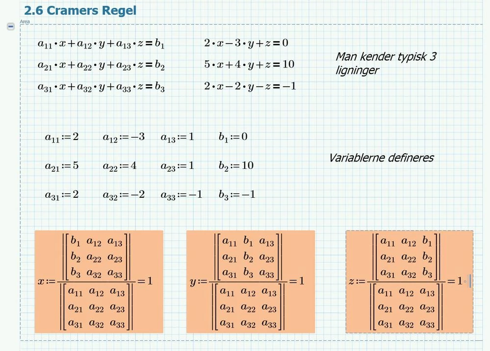

Thank you for your answer. Let me clarify my request with the following simple example: In the attached picture, I have set up a template to solve a system of linear equations with Cramers Rule. I can fill the matrice, and the results pops up, but the important thing is, that it shows the steps necessary to calculate the the solution.
I had something similar in mind for solving systems of linear equations with Gaussion Elimination, but I couldn't establish a general rule to solve them that way.

Your Cramer sheet (better: the pic you posted) does in no way show the calculation steps necessary. We son't see the determinant filled with numbers, we dont see the values of the determiants. All we see is the method how to calculate the results using determinants. Furthermore your sheet will work only with 3 equations in 3 variables and will throw an error if the solution is not uniqe (determinant of coefficients = 0) without distinguishing between the two different cases whoch can lead to that error.
Gauß is not a method that rigid as Cramer - the single steps would depend on the concrete values used. Especially when you implement pivoting. Thats why programming will be required.

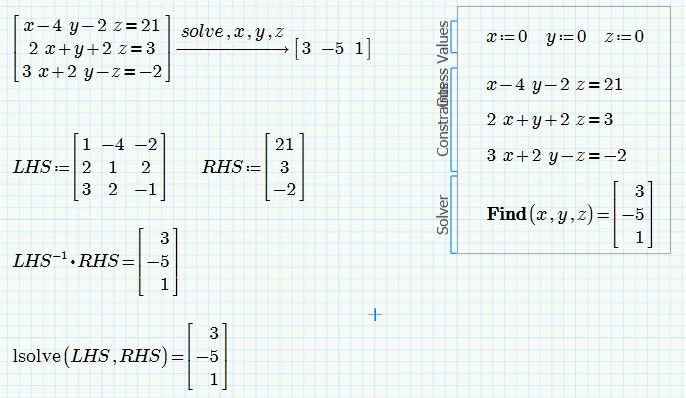

In case you don't know how to solve linear (and also non-linear) systems in Prime, here are four ways to solve your system:
Prime file (format 3.0, you should be able to open in with P31) is attached.
