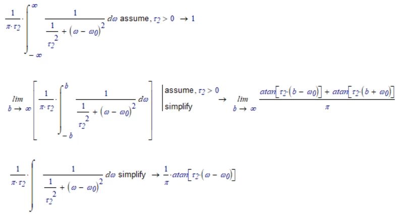

October 18, 2018
Maybe this hlps to explain.  (Mathcad 11 of course):

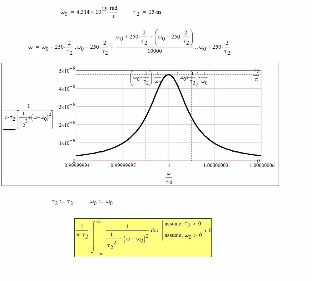

-MFra-21-Topaz IIAuthor
October 18, 2018
Thanks Luc for the answer. It would be more satisfying if you gave me an answer using mathcad 15, which is my version. If I open your file it gives me the wrong font style of the modifiers and then I have to change them to "variables". Once changed, from the results if I add" assume, omega0> 0" it returns 0.
23-Emerald V
October 18, 2018
What is Mathcad 15 /Mupad's result of the 3rd equation (the indefinite integral)?
Because that is what it (at least internally) should work with to get the result of the first equation.

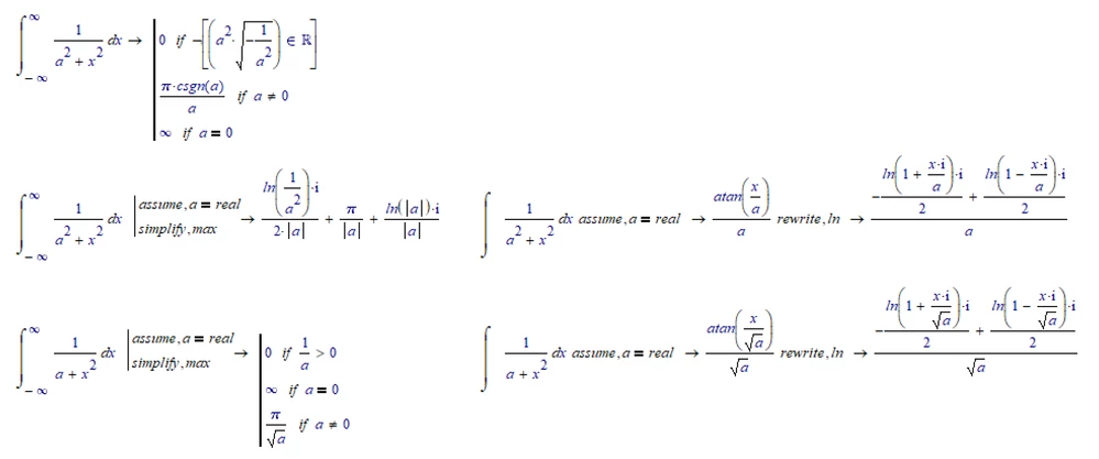

October 18, 2018
Since Maple was replaced by MuPad in Mathcad the program was "famous" for wrong symbolical integrals.
A lot of internal integral tables were corrected when they switched from Version 14 to version 15, but by far not all problems were fixed that way.
Mathcad / MuPad is just mediocre and can not compete with Maple or Mathematica in any way.
Here are some strange insights into the "thinking" of MuPad. Not sure why in the last integral the result should be 0 if 1/a >0 but something different if a not equals zero.
