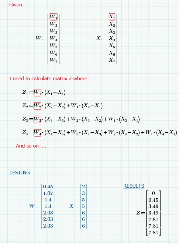

Generate a third matrix based on two input matrices.
I have two matrices, and I need to generate a third matrix by doing some math as explained in the attached file

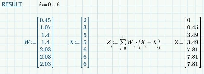

Jul 13, 2023 5:19 AM UTC
Array count is zero based by default unless ORIGIN is set to another value.
