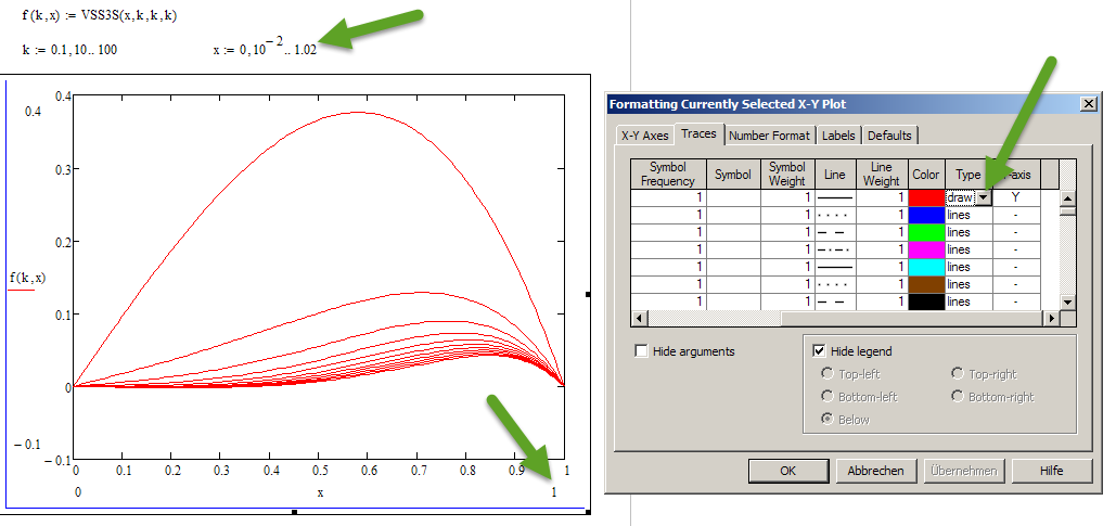

Something like this is possible:
The variable parameter k has to be a range and must be the first function argument. Guess it won't work with more than one parameter.
x must be a range and to avoid lines connecting back the first and last point of the plots you have to set the type from "line" to "draw" and make the range variable for x a littlle bit larger (1.02( than the manually set plot limit (1).
Drawbacks are:
You can't use different colors or line styles - all plots share the same
k must be a range and so it must be a linear scale. It does not work with a vector of selected values or a vector created with logspace (which would be more appropriate in your case, I guess).

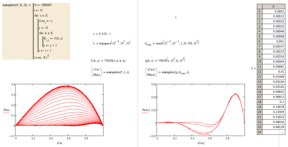

Here is a small routine which overcomes some of the drawbacks.
The abscissa values X and the parameter values k can be ranges or vectors.
No need to use "draw" or to make the x range larger than necessary.
Still just one color and line style for all plots.

You could do something like the attached, which makes it much easier to produce many plots as long as each plot has a similar structure and just varies by virtue of the varying values of k.
