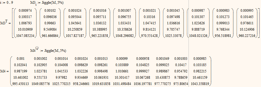

Hello All,
Could anybody help me with this question please?
I have a matrix "M" with five elements. I want to generate 10 (for example) matrices such that each element is randomly within +/- %5 of the corresponding element of the matrix "M".
Thank you in advance
Werner_EAnswer
Jan 7, 2015 10:47 PM UTC
PAYMAN RAJAI wrote:
Hello All,

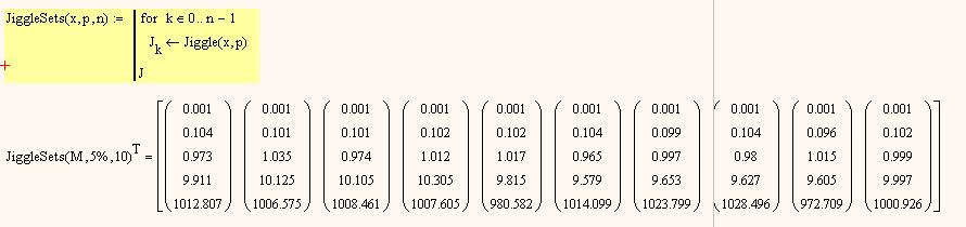

You may use something like this for a single value or matrix
You may also turn this procedure in a function
and use this function to create ten sets using a range variable

Jan 12, 2015 11:44 AM UTC
Please find in attachment version of this document in PDF format.
Werner_E25-Diamond IAnswer
PAYMAN RAJAI wrote:
Hello All,
23-Emerald V
Jan 8, 2015 9:47 AM UTC
Nice and Simple, Werner! The hallmark of a Good Worksheet 🙂
I'm too lazy to type out the range variable, though ...
Stuart
